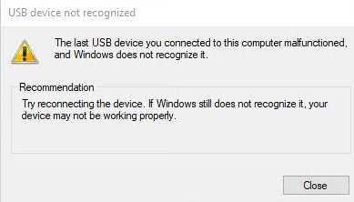

    What happens when the last USB device you connected to this computer fails?

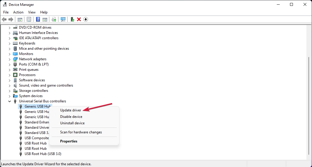

    • Select the Universal Serial Bus Controllers and expand it, Right click on the first controller and select Update Driver.

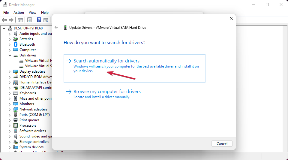

    • Now select the first option, auto search for drivers.

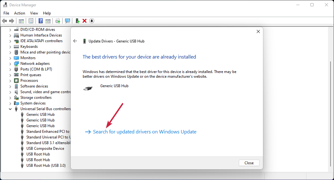

    • If the system finds a new driver, it will install the new driver. If your computer already has the latest drivers, you can also click and search Windows Update for updated driver

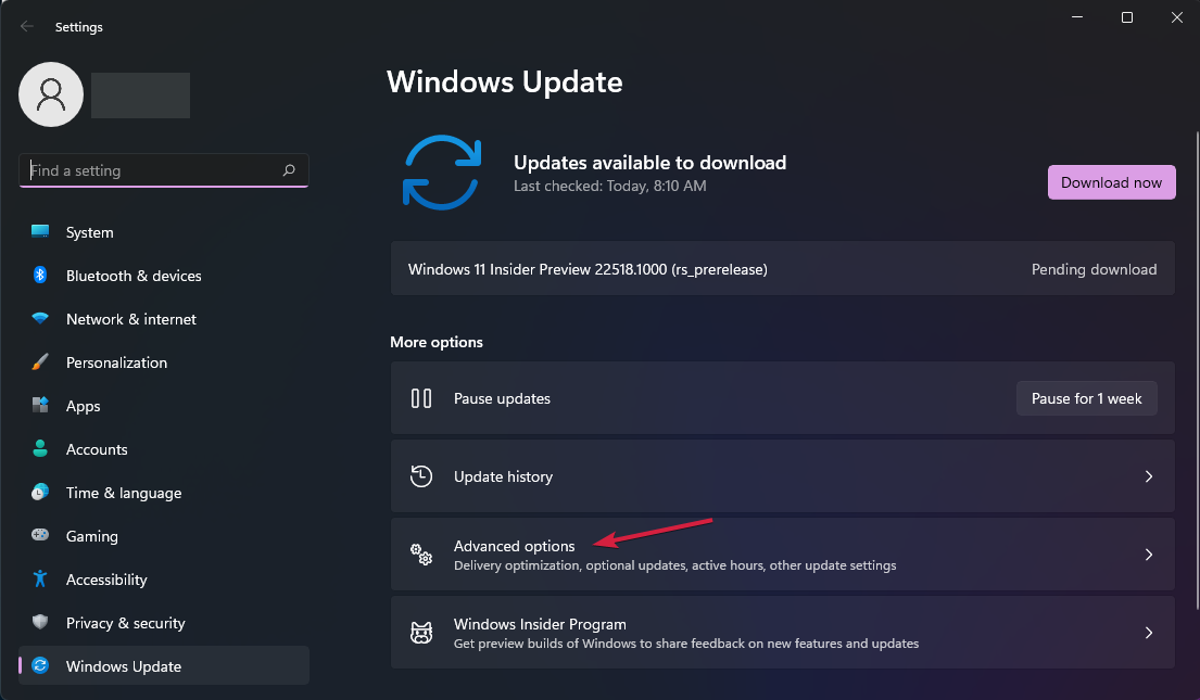

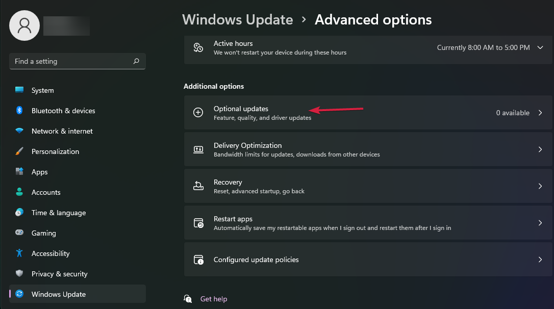

    • Then the computer will enter the Windows Update menu. Click Advanced Options.
    • Now select optional updates. If you find any driver related updates, select and install them.
    *You must perform this procedure for all USB drivers in the Universal Serial Bus Controllers section. Of course, the last part of the Windows Update is only needed once. After installing the latest drivers, the USB device should start working again.
